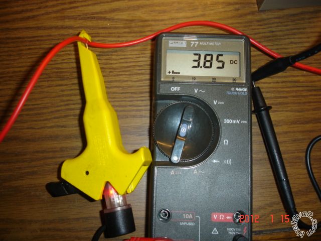

Here is my favorite test light.
power probe discussion -- posted image.
Called a Circuit Buddy.  Draws only 3.85mA at 12V.  Connect to ground to test for positive voltages and get a Red light.  Connect to +12V source and LED goes green for a ground.  Easy one hand operation to hook and pierce wire, with a latch to hold.  Probe can also be removed from yellow plastic and used as a wand/probe for tight places or fuse checking.

I have a Mac version of the light (120?) Kreg showed but with 2 x LEDs, I also agree with the Mr. I comment.

I'm going to have to find myself one of those circuit buddy's. That actually looks pretty useful. That is the one thing I disliked about my probe is taht its still hard to just pierce a wire for testing. I think I've pierced my finger more often then any wires.. lol
