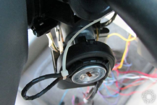

Does anyone have pictures of the 556u ring installed?  I can remote start the car with the key in the ignition.  The relay in the 556 box clicks so I think it is working.
556uw -- posted image.

Posted: February 16, 2012 at 7:34 PM / IP Logged
try placing it on the black ring, securing with some double sided tape

Posted: February 17, 2012 at 6:21 AM / IP Logged
It starts with the key in because it sees the resisted values. You need to add the relays/resistors.
Personally i would never do one without an Idatalink module...
