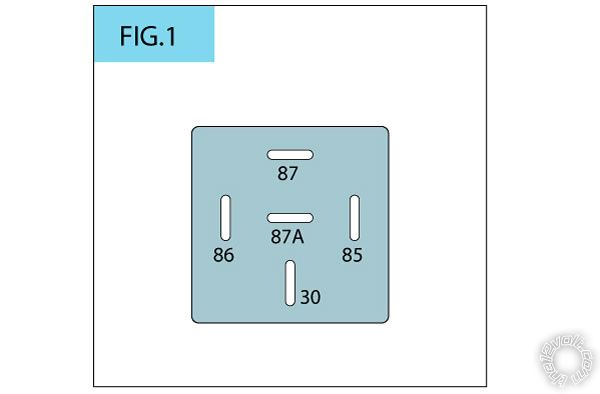

You would use a standard Bosch type 30/40 amp SPDT relay.
2004 hyundai elantra starter interrupt -- posted image.
You would connect one side of the starter wire to pin 87a in the center of the relay and the other side of the starter wire to pin 30 (common) on the bottom of the relay. That's a N.C.(Normally Closed) connection that will allow you to start it with your key at any time. When the alarm is armed, the orange (Ground When Armed) wire will engage the relay and break the connection across the starter wire, preventing it from starting.
Pins 85 and 86 would have 12v constant on one side (usually pin 85) and the Ground when armed orange wire to the other side (usually pin 86).
Hope that helps!!

All of the ignition and accessory wires must be connected as normal. Then you will want to run an ignition line (new wire) from the ignition wire to Pin 85. Then run your starter interrupt wire to Pin 86 of the relay. Cut your factory starter wire and connect the key side of the cut wire to pin 87a of the relay and the car side of the cut starter wire as well as the violet (+) starter output of the remote start to Pin 30 of the relay. The relay MUST be a 5 pin relay since Pin 87a does not exist on a 4 pin relay.

Discount auto parts and autozone only had 1 (each place) in the way of relays - one had a 4 Pin SPST and the other had a 5 PIN dual output SPST .. i know it was dual output because the 87a and 87 had connectivity to each other. I found a place that carries SPDT relays so I should be good, hopefully it was just the wrong type of relay and i should be good!

I believe the G20 is alarm only? Doesn't seem like he wants it for Anti-Grind. Instead of ignition to pin 85, shouldn't he use the 12v Constant? As alarm only, connecting ignition to Pin 85 won't interrupt the starter wire since it will only engage when the ignition wire has power. Therefore should use a 12v constant feed to it.

Based on the wire info for the hyundai, the ignition wire + the 12v constant are the same. I'm at work now, planning on getting the correct relay on the way home, wiring 12v constant to 85, and doing the rest as I had it before. This should solve it - I will post back with the update.
