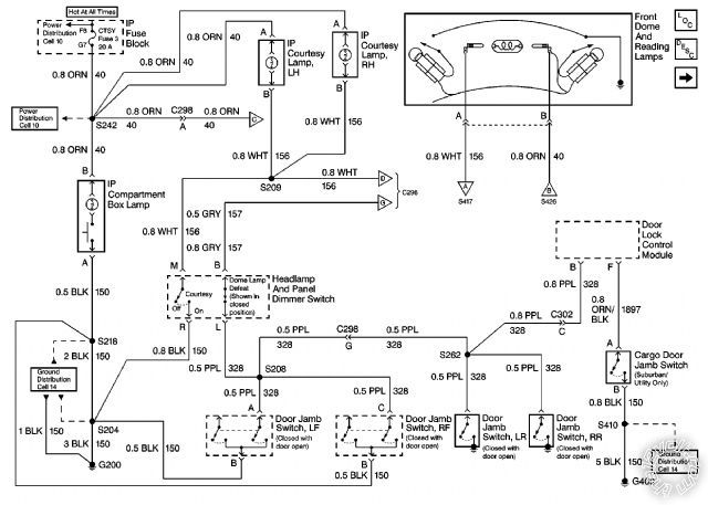

have 97 silverado interior lights not working all fuses ok want to check continuity to bcm to see where problem lies can't locate body control module, anyone?
Platinum - Posts: 13,726
Posted: January 16, 2012 at 10:06 PM / IP Logged
I do not think that vehicle had a BCM.  The domelight circuit is pretty simple in that vehicle.  Check for Constant 12 volts on one side of the domelight.  If you have 12 volts there, you need to check the pinswitches.  They are located on the end of the dashboard.  They fail regularly.

Posted: January 19, 2012 at 9:54 PM / IP Logged
here is a 1998 schematic for interior lights.
i dont have one for a 97. hopefully their similar.
is it only interior lights or other stuff not working too?
