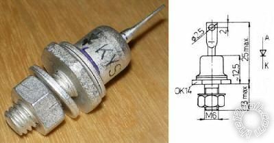

You could use something like this. It's rated for 30amps and range from 40-600V
additional ignition, accessory, etc., diode -- posted image.

I have six amp diodes in my box at work and there about the size of a shallow 10 mm socket . There pretty big. So I can't imagine the size of a 20amp

According to the diagram on the right that nut at the cathode is a 10mm spanner size!
