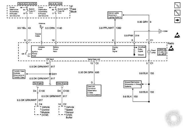

The yellow wire from the Pioneer radio needs to be connected to the orange wire in the radio harness. Check that the 15 amp radio fuse under the hood isn't blown first.

it sounds like they hooked the yellow of the radio to the yellow of the car. then they probably hooked the red from the radio to the orange of the car(or maybe hooked it also to the yellow).LOL
the yellow of the radio needs to be hooked to the car's orange as stated above. the red from the radio hooks to the yellow in the car.new pioneer radio, no memory settings -- posted image.
