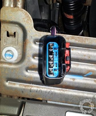

ok, another question. Upon unplugging the 5 pin connector, there are only 4 wires. The MUX wire is nonexistent. I'm stumped...
thanks again.

offroadzj wrote:
Are you sure its the mux that is missing and not the starter? Some will not have the + starter, and depending on how you are looking at the plug, they could appear to be the same pin...
Apparently you double posted, and it happened to go onto the next page... so in case you missed this reply...

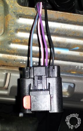

2007 jeep wrangler remote start prep - Page 2 -- posted image.2007 jeep wrangler remote start prep - Page 2 -- posted image.
Pretty sure I'm looking at it correctly. These pics are from my actual vehicle. Am I wrong?

You need to look at the plug from the back of the plug. The violet/brown (can't see the brown, but I can take bets it has a brown tracer) is your mux wire, and the blue/red is your 12v. DO NOT connect the main r/s 12v input to this wire. It is only fused at 10amps. Not sure if you have another option (ie kickpanel, etc) but I always take the 12v directly from the battery with an additional 30amp fuse right at the battery. You do not have the starter wire so you will need to follow wire diagram C or D (depending on if you are going w2w or d2d). It MAY not require the mux relay, but check the diagram before you just go on my word... I don't know that vehicle exactly.
