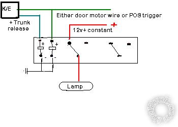

Actually quite simple, use your k/entry unlock to turn it on and the trunk pop to turn it off. Use them to feed a dual coil latching relay, Omron G6CK-2114O-US12DC available from RS components, Mouser or Farnell, all available in the UK. You can use NEG or POS triggers, at least 5amp switch capacity.
Posted: February 05, 2012 at 5:27 PM / IP Logged
Here you go:- DFZ_latch.bmp
Dead simple I'm assuming pos unlock motor wire or unlock trigger.
If it was NEG, just join the constant 12V+ to the plus side of that coil and bring the trigger to the NEG side.
Note, I said the green wire was LOCK in the diagram, it should of course have said UNLOCK.
