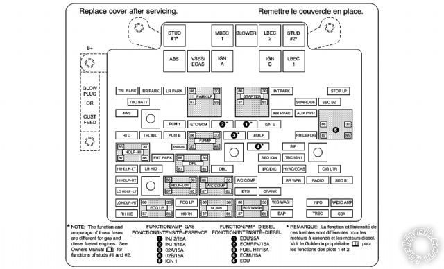

     a friend of mine has a 2003 Chevy Tahoe with the Bose system.Can someone tell me where the fuse for the factory amp is? i have not been able to look at truck yet. i know the amp is supposed to be in the center console. i told him to check at the amp.

I believe it's under the hood in the fuse box, labeled Radio Amp or something like that.

Under hood fusebox.  Bottom Right corner of the picture.  As stated earlier, it is labeled Radio Amp.
fuse location, 2003 Chevy Tahoe -- posted image.

Thanks for all the help he has power at all fuses for the audio system. I think the problem is at the amp connectors. There was tech service bulletin # 020844020 that covers a problem with the connectors.
