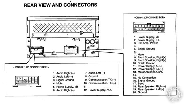

I have a 2002 Lexus GS 430 with nav and the Mark Levinson surround system and having a hard time finding a wire diagram for the amp or the headunit. I need this diagram to figure out whether or not there is an amp turn on wire or a mute wire in order to install a Parrot hands-free system. Can I use a DMM somehow? Does anyone know where I can get software for audio wiring info for any make and model?

finding a mute wire, 2002 lexus gs 430 -- posted image. Battery BLUE / YELLOW (+) RADIO HARNESS
finding a mute wire, 2002 lexus gs 430 -- posted image. Accesory GRAY (+) RADIO HARNESS
finding a mute wire, 2002 lexus gs 430 -- posted image. Ground WHITE/ BLACK (-) RADIO HARNESS
finding a mute wire, 2002 lexus gs 430 -- posted image. Illumination GREEN / WHITE (+) RADIO HARNESS
finding a mute wire, 2002 lexus gs 430 -- posted image. Power Antenna RED / BLACK (+) RADIO HARNESS
finding a mute wire, 2002 lexus gs 430 -- posted image. Amp Turn On BLACK/ ORANGE (+) RADIO HARNESS
techservices.audiovox.com  It is free information, you just have to take a few minutes and set up the account.

On Toyota and Lexus the mute wire is usually Pin 7 on the 20 Pin Plug. I usually test for power and ground to get my barring on the pin locations, then count out to 7 from Pin 1 which tests as battery. Which is Blue / YELLOW according to the above post. Pin 11 is directly below pin 1 which will test as an accessory, so make sure you are testing battery and accessory correctly. This way you end up at pin 7 not pin 17.

Sweet!
Thanks for the help finding a mute wire, 2002 lexus gs 430 -- posted image.
