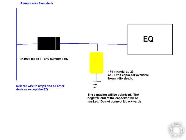

You are correct in your assumptions.  Following is the diagram, just substitute Radio's red wire for the EQ's blue wire.  Substitute Vehicle switched power wire for Remote wire from deck.  Capacitor I suggested is much larger than the cap for the EQ, so you will need a 3 amp diode instead of the 1 amp diode pictured.

Thanks. I will give it a try and post back the outcome. I am glad you attached the drawing because I would not have grounded out one leg of the capacitor. I would have ran it similar to how a fuse is ran. So I have learned something from this:-)

Thanks for your help. I do have one additional question. At first I wired it backwards because I couldnt tell which end was neg. One of the ends was black, so I figured that was the negative end. It worked great though. The stereo stays on until I open the door and then it goes immediately out. The only issue is it is 65 degrees here in the shop and the capacitor gets up to 110 degrees. I am worried about having it under the dash especially in the summer months.
Then I got to looking at it and thought I might have wired it backwards. So I reversed it and now it is quite a bit cooler, about 75 degrees. The issue now is that the stereo stays on for about 5 seconds after I open the door. I guess that is better than before, but I would really like it to go off immediately after opening the door. Do you think I might need a smaller capacitor? Any idea in size recommendation?

I see where I goofed up...I bought a 4700uF instead of a 470uF. I will pick up another one tomorrow and try that and see what happens.
