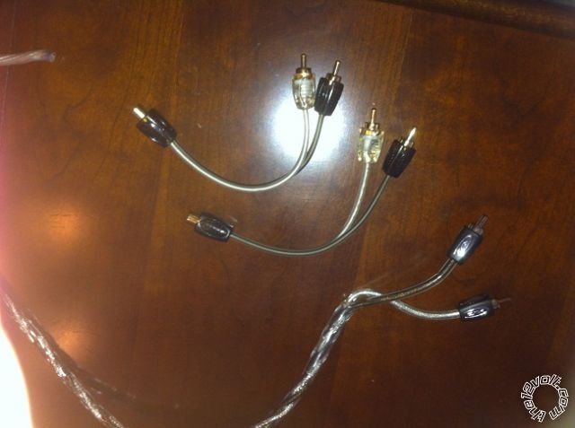

The guy at the sound shop told me since my head unit only has front and rear RCA's on the back i needed these
1997 vw jetta gt complete upgrade trouble -- posted image.

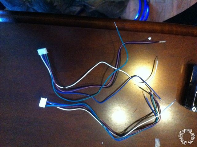

he also recommended using speed wire to bypass the premium audio in my car.
i have no idea how to do that? all i know is that he said to hook one end to the harness of my radio and to run the other end back. 1997 vw jetta gt complete upgrade trouble -- posted image.

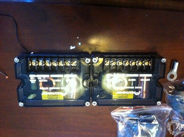

how do i run and wire the two passive blocks?

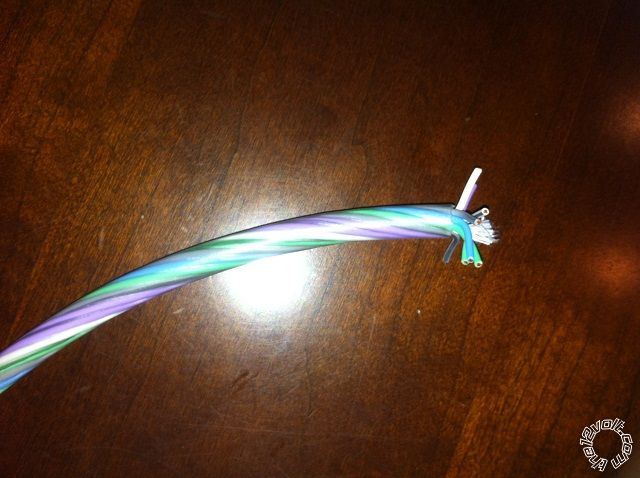

One last question. What in the world do these go to?

Rca adapters is ok,Power wires are ok,Crossovers wiring look at the connectors, input= speakers wires coming from amps. front -rear-left and right.
Outputs 2, one output (+and- wires) tweeters
 other one (+ and - wires) mid range speakers
you will need 4 crossovers.
You do not need speed sensor unless it is for navigation system.
