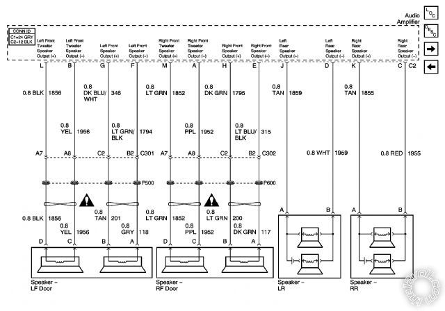

on this 2006 impala, are the how are the tweeters wired , is there a 6 channel amp or, they wired to the woofers with a cheesy crossover/bass blocker? the reason im asking is i want to install aftermarket 6.5, does full frequecy go to the door speakers?

this GM schematic is for a 2005, maybe its the same. 2006 impala, speaker wiring -- posted image.

looks the same, i put in aftermarket kenwoods, they rock, shes happy
