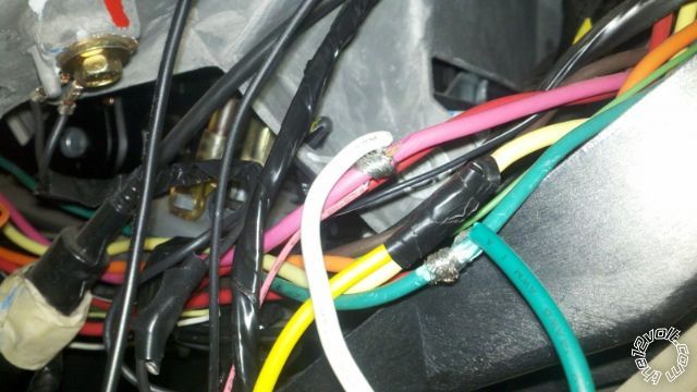

I have tried wiring without the data link and obtained the exact same results.  It will go into start mode and the starter will click one time.  I have a good ground connection and I cannot figure out what is going wrong here.  The manual states that the parking lights will flash if it fails to start but that is not so in my installation.  I have listed below my current connections along with a pic of the wires connected to the ignition harness.  I do not have the green or white wire soldered yet due to uncertainty of their placement.
600S
Red- 12V Constant
GREEN / WHITE-NC
RED / White- Soldered in with 12V constant listed above
White-Pink at ignition harness
Blue-NC
Yellow- Yellow starter wire at ignition harness
Green-Green at ignition harness
Black- Grounded to body
Violet/white- Lt. Blue/Blk of the INSTL+
Blue-White on INSTL+
Blue/Blk- Lt. Blue on INSTL+
Black (-) Status Out-  Blue (Neg while running on INSTL+)
Yellow/Blk- ORANGE / Blk on INSTL+
4 wire harness to INSTL+ only has red connected to 12+ constant and the black wire is grounded.  The blue and white wires are not used.

Platinum - Posts: 7,827
Posted: March 11, 2012 at 12:23 PM / IP Logged
Here are the ignition connections.  Acc2 is not shown/powered and would require an additional relay.
CM600-s           Impala
Red      Red     +12V
RED / White      Red     +12V
White Orange   ACC1
Blue   Green    IGN2
Yellow Yellow Starter
Green Pink     IGN1
Nice solder connections!  2003 impala remote start issues -- posted image.
Posted: March 11, 2012 at 12:36 PM / IP Logged
Looks like you had the Impala's IGN1 powered from the CM600-s as an Accessory wire.
Here are some more connections you didn't mention:
CM600-s             INT-SL+
GREEN / WHITE      Pink/Black   Parking Lights (-)
Green  (Thick)   Pink              Ignition1 ( continues to Pink Ign1 wire at ignition harness )
That fixed it! Thanks a million!!!
