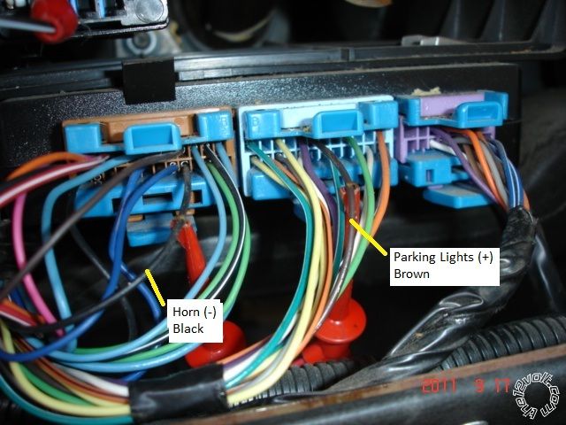

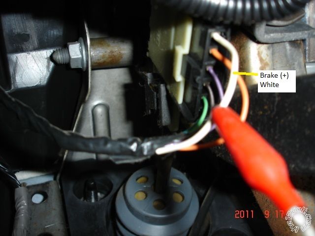

The DB-All seems like a bit of over-kill for that application.  ( A DEI 555L would handle the Passlock2 for around $15.)
Anyway, the correct firmware is 401.GM5 v1.06.01.  Follow the Type 6 wiring diagram and go W2W with all the necessary
connections ( don't use the D2D harness ).
Connect :  10 Pin Harness - GWR ( to 4113 Blue wire ), Ignition1 & Starter  ( might as well connect the Lock & Unlock )
   14 Pin Harness - +12V, Ground & OBD2 J1850 Data
   12 Pin Harness - RAP & both Passlock2 wires ( might as well connect the Tach & see if the 4113 will learn it. )
Follow the programming instructions on Page 15 for W2W and Type 6.
Here are some photos for Silverado wire location :
avital 4113 -- posted image.
The 4113 should come set for Flex Relay = Ignition2 & Positive Parking Lights.  Program the 4113 to Tach Mode ( Menu2, Item 1, Opt 4 ) and do a Tach Learn.

The Avital 4113 heavy gauge Pink/White wire on the 6 Pin connector should be connected to the Silverado's White Ignition2 wire at the ignition harness, not he Brown ACC2 wire.  The Avital 4113 Pink/White wire default programming is Ignition2.  You will have transmission problems if you don't power this White wire as IGN2 wire during remote start.
The Brown ACC2 wire can be power with an external 30/40 Amp SPDT relay controlled by the 4113's (-) Accessory Output if desired.
