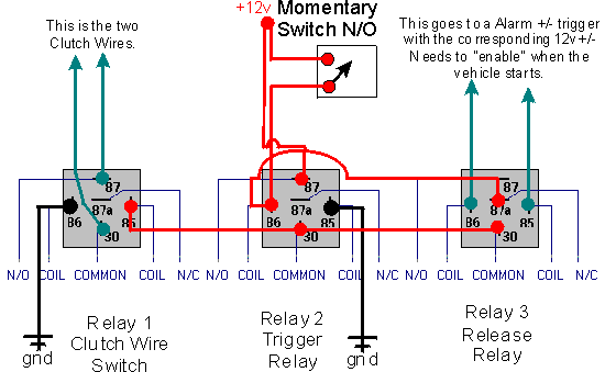

I took a stab at this and sketched this out on a piece of scrap paper so it's a complete mess. I'll do it up on the computer and post it up. It will use three relay total, a momentary switch, and the key will be an input from your alarm/command start that is either +/- when the vehicle starts to "break the wires".

Here is what I came up with:
Button/Switch that resets? -- posted image.
A few quick points - I haven't tested this so I'm "pretty sure" it will work. Second, You might want to get someone with more experience with Diodes cause I think that all three relays need one across their respective coils. Third point, you will notice that the Relay #2 will stay on constantly once you active the push-button switch, I don't know how this fits into your install BUT you may want to consider the small current draw.
Now for the instructions: When the button is pushed, it momentarily charges relay #2 which creates a permanent loop through #3's N/C circuit and can only be broken when #3 coil is engaged. The hot-wire from this also charges #1 to close the clutch wires.
Hope this helps, if not then let me know and I can help you out further.

So I should buy a push button switch? Is there any specific type that I should buy?
Also, on terminals 85 and 86 of the third relay, would both of those terminals go to a +12 volts power source that is only +12 volts when the car is started? Or do they each go to something else? I'm kind of unclear on this.

Any momentary switch that is Normally Open will be fine. Radio Shack has piles of different kinds that will work, just make sure it is for 12V and will take a bit of current e.g. 5amps.
For 85, you will need to find something that is positive when the vehicle is running, then you would simply ground 86. BUT it could be the opposite, e.g. you can find something that turns negative (12v-) when the vehicle is running and then you would need to put positive (12v+) on the other one.
 It would be easier if your command start (or alarm) has something that "enables" for 2 sec's once the vehicle starts. Take a look in your manual and see if there is something like this OR post the make/model of the command start and we can take a look.

I thought about it a bit, and I figured that it would probably be easier to simply hook terminal 30 of the first relay to ground and terminal 87 of the first relay to the (-) remote start toggle switch input of my alarm.
As far as the third relay's coil, my alarm is an Autopage RS-650, and I just spent a few minutes trying out some of the outputs, but I don't think that any of them are going to work for this. I thought about using the wire that gets +12 volts when I press on my car's brake pedal, but realized that if I did this, I'd hear the clicking noise of the relay switching whenever I press the brake pedal. So now I'm thinking that I may hook terminal 85 up to my e-brake wire which produces +12 volts when it is down, and then simply hook terminal 86 up to ground.
Also, does anyone know for sure if I need diodes across the coils on the relays? This is the part that I am the most unsure about.
