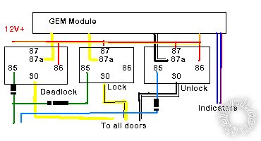

First diagram including deadlock if the testing works out OK
Note on both diagrams 12V+ supply is from orange / YELLOW (test, this is all from memory) at the GEM box.
Also if indicators are needed use the + blue and blue/red wires in the middle of the GEM box. ford_no1.bmp

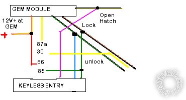

Note I've also given you the trunk release, BLACK / YELLOW at switch going to GEM box.
In this diagram, if your K/E is a 2 wire please use the 3 diodes, else there's a chance you will fry the K/E.
If it's a 6 wire, give us the list of wires and what each are for and you will then only need 1 relay.
The work around:- ford_work_around.bmp
