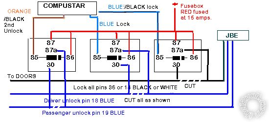

Assuming this is a BMW M3, you will need 3 relays and 3 1N4004 diodes.
Go to the JBE (Junction Box Electronics), behind glove box, 47 pin plug marked X14270.
Your 12V+ source will be a thick RED at the adjacent fusebox. You
MUST TEST FIRST
Now follow the diagram:- bmw_3_series_05_on_priority_unlock.bmp

So now you see why the rules state "specify make, model and year".
Over here I've probably done more BMWs than any other make.
This diagram is for an 08 but if you have the one wire multiplex locking system it still applies, N.B. That question about finding 12V+ was puerile, TEST.

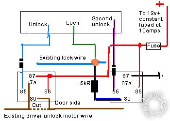

Posted: April 18, 2012 at 10:21 AM / IP Logged
This one's for non priority unlock, note the wire colours on a Comp are different.

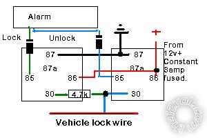

Posted: April 18, 2012 at 3:17 PM / IP Logged
my tech sheet says i need a 1kohm..and on the diagram you showed me is different..will that be an issue??
