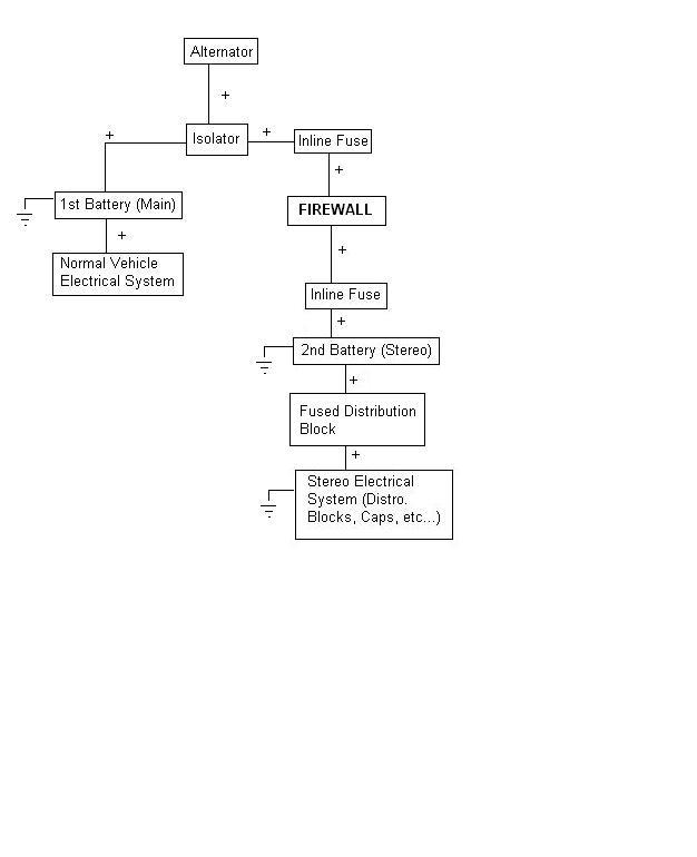

An Isolator acts as a brain and controls the flow of current from the Alternator to the batteries. If it is functioning properly, it will not allow 1 battery to draw current directly from the other battery, just the alternator. Most common set up is... Alternator to Isolator. Isolator to 1st and 2nd battery (you will use different + leads for both). From here, the 1st battery will continue to run the rest of the vehicle's normal electrical systems. The 2nd battery is where you would run the stereo from. Hook up all your distribution blocks, power wires, caps, etc... from the 2nd battery just like you would if you only had 1 battery. You can even hook up the Headunit's power to the 2nd battery as well, and completely isolate the entire stereo from the stock electrical system (with the exception of the alternator of course). If you tell me exactly what you have in your system (headunit, speakers, crossovers, distribution blocks, amps, subs, etc..., then I can try and create a basic layout for you). In the meantime, this is a crude pic that I just did, so sorry if it's not the best quality! BTW, I fuse the hell out of my systems, hence all the inline's...
Multiple Optima Battery Setup Questions?? -- posted image.
