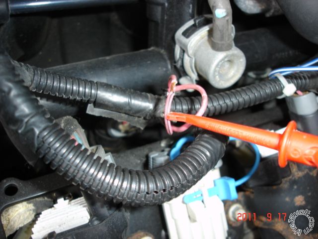

HI everyone does any! have the tach wire color and location on a 2002 gmc sierra 3500 6.0 i need help thank you

Here is Tach wire info from DEI :
Tachometer     White  (ac)       @ instrument cluster (gas or diesel) or ECM (gas)
 The ECM (Engine Control Module) is located near the battery and down low between
 the fender and fan under a BLACK plastic cover. On the 4.3L engine the TACH wire is
 at Pin 20 in the connector marked "RED".   On the 4.8L, 5.3L and 6.0L engines, it is
 located at Pin10 in the RED connector.
You can also get a Tach signal at any F.I. using the non-common colored wire.  Here
is a picture of this wire on a 2002 Silverado 5.3L engine :
2002 gmc sierra remote start -- posted image.
