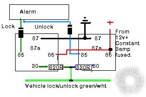

Looks like something's not right.....I finished all of the connections and thru testing I identified 2 problems.
1. The unit will unlock the doors, but will not lock them. It doesn't seem to matter if I have the 1k ohm resistor tied into the 451m lock wire or not.
2. Parking lights don't flash. I wired them up as positive using a +12v source, but Im guessing the polarity is negative so I'll try that next.
Hopefully I can get some idea around the locking issue. Also, this alarm is weird....my Viper chirps once for arm and twice for disarm but this Audiovox is different. It chips once for disarm and twice for arm...weird.
Posted: April 24, 2012 at 1:55 AM / IP Logged
From your last post I'm wondering whether you have even read the instructions or tested anything in the car.
That's with reference to the lighting polarity and the locks not working.
Your approach is going to mean this $$$$$$
If you read your manual it will tell you about correct the chirp sequence, Cliffords always did 2 arm and one disarm, Viper the other way round. There's no convention here, depended on how the mnufacturer designed and built the alarm.
Posted: April 24, 2012 at 1:56 AM / IP Logged
And yes, hood and trunk pin are instant triggers.
Posted: April 24, 2012 at 2:04 AM / IP Logged
This is the lock wiring, similar to this picture though you only use the one resister and 2 x 1N4004 diodes:-
