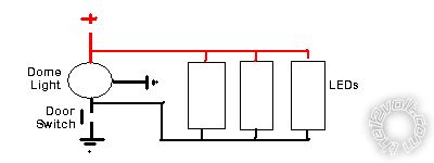

Posted: April 29, 2012 at 7:37 AM / IP Logged
Use the constant 12V+ and the wire that switches from 12V+ To NEG (GROUND) when the door is open.
The diodes aren't needed.
I have 8 LEDs in my roof lining doing that.

Posted: April 29, 2012 at 10:15 PM / IP Logged
Oooo - that could be my bad... I was thinking if another circuit grounded the dome.
And to think I've been preaching ground-switching to negate the need for diodes!
Posted: April 30, 2012 at 2:19 AM / IP Logged
It IS ground switched! Where do you need diodes here?

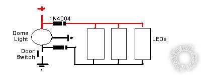

OK maybe in these circumstances:-
The second diagram is where there's an alarm.
If I was to diode, I'd actually do it on the power feed to the dome light.
Again, none on my set-up.

Posted: April 30, 2012 at 2:36 AM / IP Logged
Yep, that's what I meant. Sorry.
