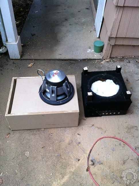

Well, I created my own with the help of the RE Box calculator. This is where I am currently
Alpine Type R Ported Box -- posted image.
Just trying to figure out if I want to invert the sub or not. The black box was the original box. It was roughly .91 cubic feet with 5 3/4" holes drilled in it, and a gaping hole where the cables came through the box. It was horrible, but hopefully I'll get it straightened out!
