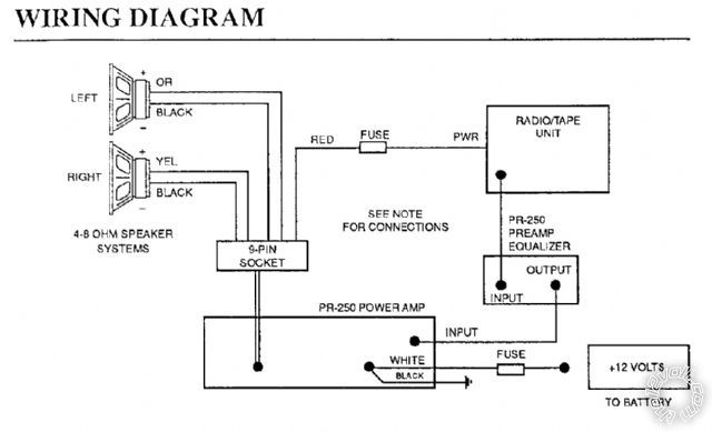

So if you do not disconnect the 12 volt battery power to the RED wire but turn off the Head unit with Head unit's on and off switch the Head units front panel light turns off but the internal electronics are still powered up. correct?
Sounds like the RED voltage sense wire works kind of like the old Fosgate power amps. Head unit RED wired is wired into power amp. When Head unit was turned on, the amp would sense power draw thus turning on amp and sending 12 volts to the head unit through the same wire.
check out below
head unit power on off switch -- posted image.

hi,
the old Fosgate circuitry would be current not voltage sense. remember back when those amplifiers were made not many radios had a remote out lead, or even a memory lead. the radios had analog tuners and mechanical tape transports.
mark

Platinum - Posts: 13,725
Posted: May 17, 2012 at 11:33 PM / IP Logged
Back in the day of the Rockford and Pioneer current sense circuits, the red wire powered the radio.  If the radio had a Memory wire, that is what it was, memory to power the clock and memory for presets.
