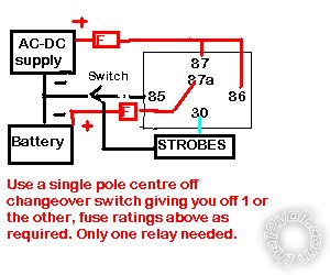

Posted: May 19, 2012 at 11:30 AM / IP Logged
Or use this diagram, it gives you a choice of sources, in fact depending on the load current of the strobes with a heavy (i.e. current capacity)switch you don't need a relay:-
Posted: May 19, 2012 at 11:50 AM / IP Logged
You don't need a relay use Mouser SPDT switch, part no- 611-CG103J11S205QF, about CAN$2. Handles 15 amps.
Use it as your ON (Ext) - OFF - ON (Batt) switch.
