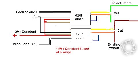

Easiest way is to use 2 x aux outputs set as timed, the relays just carry the power, same diagram as "adding an actuator" in the relay section.
If you don't have two timed aux outlets, you could use 2 x 528t timer relays or similar.
Posted: May 31, 2012 at 1:55 AM / IP Logged
Here's a modified from mirror fold diagram using a pair of 528t's,thus you can use either the lock or unlock (-) signal or a pair of momentary (pulse) aux outputs.
If you don't have an existing switch take take each orange wire (on the right) to ground.
Posted: May 31, 2012 at 1:57 AM / IP Logged
It might help if I post the diagram.

Iam using door trigger switches to open and close the 12v power to the relays and I have split the one neg. pulse from the alarm. The actuators are to open and close the trunk.Will the 528t relays you suggested be timed to stay on till the power is shut off? I would like to know before I by them.   Thanks for your help Charlie
Posted: June 02, 2012 at 3:38 AM / IP Logged
Yes they are 20 amp timer relays.

I got the 528t relays and hooked them up like the diagram showed. I might have something wrong becouse it's not working. On the actuators there are two wires one for up and one for down. When power is aplied to one the other wire is used for ground for the motor. Do I have to change something for this to happen? Or add another relay?    thanks Charlie
Posted: June 13, 2012 at 3:18 AM / IP Logged
Take another look at the diagram.

Posted: June 14, 2012 at 5:33 PM / IP Logged
Howie, you were right I didn't have one of the wires conected to ground like it should have been. It's working fine now. Thanks for all your help and patience .Thanks again Charlie
