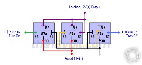

I have built this relay posted on the 12volt site:
momentary to constant on -- posted image.
I am using a Momentary switch which sends a 5v positive pulse. My question is how do I get the same switch to send the positive pulse to turn the circuit off? I am trying to use a stock Mercedes switch for my application. Need help, I'm new to this.

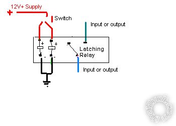

Here's a layout, note the coils are polarised.

I just realised you wanted POS (+) switching all you have to do on those Omron relays is to ground both (-) sides of the twin coils and individually feed the (+) sides from your switch. Look at this.
