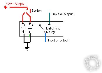

Shown is an Omron dual coil latching SPCO, also available in DPCO format: 79C_latch.bmp
As long as you observe coil polarity you could have a constant neg (-) and switched pos (+) or vice versa.
If you look down on some of these relay posts it will give you the correct part numbers, Farnell or Mouser in the US stock them.
Sorry it's 12:15am here and I'm too tired to start Googling for you..Omron latching relays.
Up to about 10 amps current handling.

Omron part numbers:-
5amp/12VDC G6BK-1114P-US-DC12
10amp/12VDC G6CU-1114P-US-DC12
