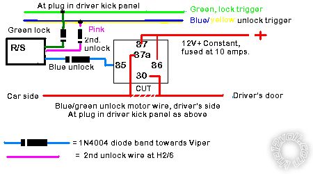

c) I was planning on using the negative lock signal to trigger a Bosch relay to fire the driver's door unlock, and then the 2 step unlock to fire all door lock motors. This seems to make sense in my head, but I am of amateur level knowledge.

Posted: July 09, 2012 at 1:59 PM / IP Logged
a) Not sure but I would still connect, might be unknown factors.
b) No in the circumstances but that wasn't what I meant see below.
c) Fine but two things, first with Autopage look closely at the lock/unlock wires. They are shown as +/-.
This means a flip flop output, diodes are MANDATORY you will have all sorts of problems with the locking system otherwise.
Also the Autopage second stage lock diagram is WRONG, apart from the fact that the correct term is priority unlock.
This diagram corrected to Autopage and Corolla colours shows how. Note 3 diodes for a start:- 2D7_2nd_unlock_with_low_outputs.bmp
