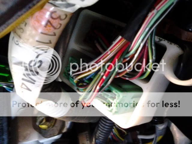

The essential info. 1990 Honda Accord LX Sedan, all stock and never had alarm installed.
I have tested all of the wires that needed to be connected to the alarm. The only one I cannot confirm to be the lock and unlock with my multimeter.
The connector as pictured below is the 2 pin gray plug wrap in blue tape together with the wire harness black loom. The wires in the plugs are BLACK/ red(unlock) and BLACK/ white(lock). To test it, I ground the black of my multimeter and put the red on the connector wire, one at a time. While the multimeter is connected, I flip and switch and looking for voltage drop to zero or close to it. Nothing really drop on either wire. At rest the constant voltage shows 5.16V, as I flip the switch in either direct, the voltage goes to 5.09V, but not even close to zero. I follow this video to do my testing.

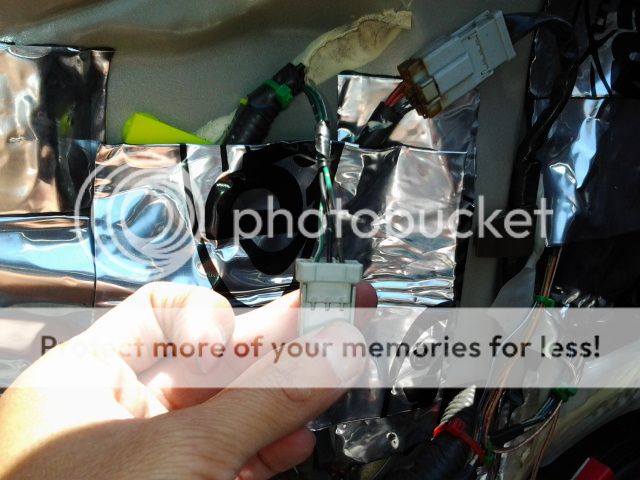

What I did to verify my testing method was to test the plug at the actual switch itself, the 2nd picture below. The wires are GREEN / WHITE, middle is black as ground, and GREEN/ red with 2 silver dots. I test both of the green wires and the voltages go from 5.16V to zero each time I flip the switch then back to 5.16V. Now that is how it's suppose to be tested and show those results.

Picture 1: 2 pin gray plug wrap in blue tape under the carpet.
having trouble finding the lock/unlock wi -- posted image.
Picture 2: 3 pin plug right at the driver's door.

To test for a Type B (-) lock wire, set the DMM to +20V DC.  Connect the Red lead to +12V constant and the Black lead to the
suspect wire.  When the lock (or unlock) is pulsed, you should see the DMM go to +12V.
Note from DEI :
The station wagon uses GREEN / WHITE for lock and yellow/white for unlock. These wires are found either in the drivers door harness
or under the rear seat.
Locate the large harness in the lower below the carpet in the drivers kick panel. Near the foot rest you will notice a piece of blue tape
attached to the harness itself. Reach around to the underside of the blue tape to locate a 2 pin gray plug with the lock and unlock wires
attached to the plug.
Power Lock           BLACK/ white  (-)      lower drivers kick
Power Unlock        BLACK/ red   (-)        lower drivers kick
Looks like the top picture has the correct wires...
