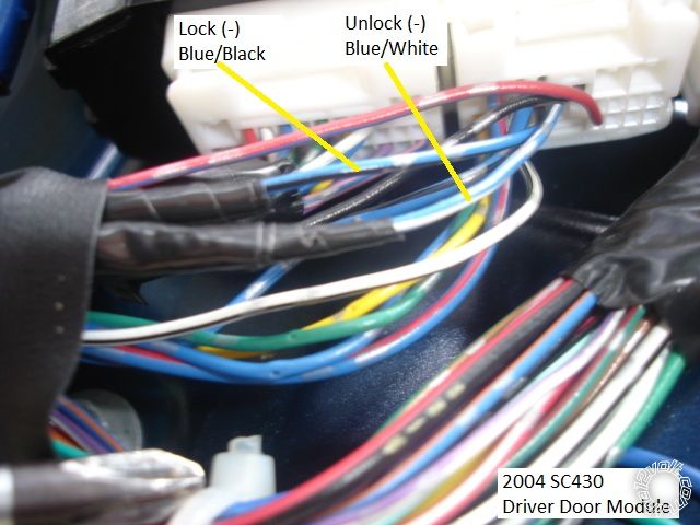

This is a picture of the door lock and unlock wires at the drivers door module above the 6X9 speaker.   Shown are the key cylinder
wires and will lock/unlock, arm/disarm the Factory Alarm and allow comfort closure with extended length pulses.
2002-2007 Lexus SC430 Remote Start w/Keyless Pictorial -- posted image.

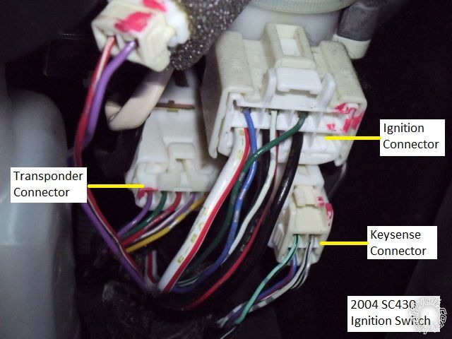

This is  picture of the ignition cylinder with the ignition, transponder and keysense connectors marked.

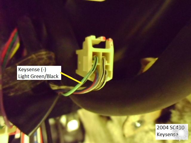

This a close up the the Keysense wire.

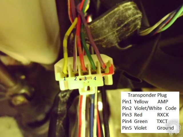

If using an iDatalink bypass module, here is a photo of the transponder connector.

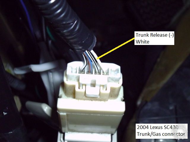

This is the Trunk Release wire found at the release switch.

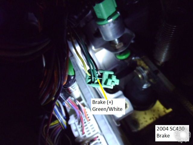

Here is a shot of the Brake wire at the Brake Pedal connector.

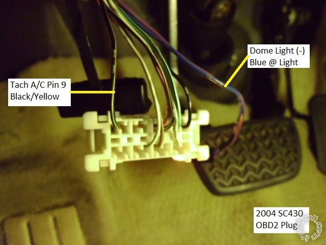

This is a photo of the Tach wire at the OBD2 connector.  ( Also shown is the Dome Light wire at the lower dash courtesy light.)

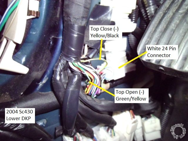

There are two places to get the Convertible top Open and Close wires, at the switch or in the Drivers Kick Panel.
Below is a picture of the wires in the DPK.  DEI's info on these wires is reversed - Open is GREEN/ YELLOW and Close
is Yellow/Black.  ( Always pays to test and verify everything. )  Setting the AUX output to 31 seconds for Open and
21 seconds for Close worked well for this car.  These functions only work while the engine is running.
