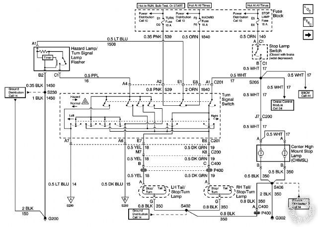

i need to know what color wire is for the left turn signal on a 1998 pontiac grand prix gtp. it would be the wire that comes from the steering column and plugs into a large connector underneath the console. thanks in advance.

currently the wire is loose where it goes into the large black connector underneath the dash. i got to jiggle/move the wires around to get it to blink when i turn the left turn signal on. its a crash waiting to happen if i dont get this fixed.

does this help?98 gtp: left turn signal wiring schematic -- posted image.

thx itsyuk...i dont know yet....trying to decipher what wires go where from the left turn diagram lol

Light blue 14 oh those stupid US systems with combined indicators stop lights.

so can someone tell me what color is the left turn signal wire that goes from the steering column to a connector harness please?
Posted: July 25, 2012 at 5:27 AM / IP Logged
I've told you one already but here's both AGAIN.
Front light blue at pin 14.
Rear yellow at pin 18.
