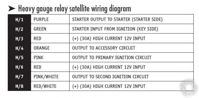

avital 5103 on nissan altima 99 -- posted image.

Nissan designed that circuit to be separate for some reason.  The 5103 should allow you to program the H7 Pink/White wire as Starter2
and connect it to the vehicles Starter2 wire.  Just make sure all three Red power input wires ( H3, H6 & H8 ) are connected to a suitable
+12V constant source.
