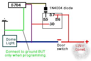

So i got a false alarm last night, do i need to diode isolate the dome light wire too? If i do id rather do this since itll be easier to isolate one wire instead of all 3 door trigger wires being its a supercrew.
Posted: August 23, 2012 at 5:41 PM / IP Logged
You will need to follow this diagram for dome light supervision:-
