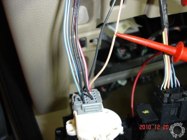

Don't see too many Freestars.  Never tried the resistor method on the Parking Lights but I have successfully used the one relay method shown by Bulldog.
Here is a photo of the necessary wires at the switch ( non-Auto Headlights ) :
2005 ford frestar -- posted image.

Think I'd go with the DirectFax 1072 setup for the Parking Lights with AutoHeadlights.   Looks pretty much the same as the Bulldog info.
