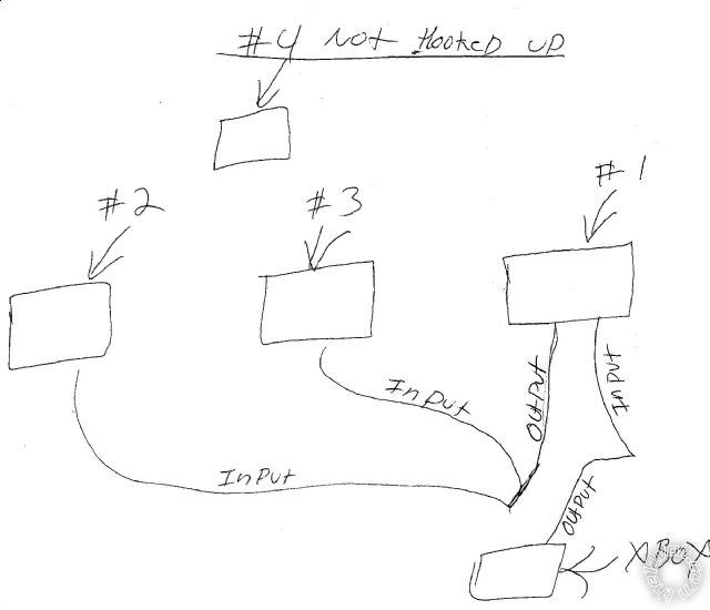

ok so i have two headrest tvs one tv on the roof and one tv up front and i have a xbox for all 3 tvs in the back..... i have all the tvs hooked up with rca cabls and one of my headrest dvd tv is the main tv but tomorrow i am going to make the front tv the main one.... anyways the #2 tv is hooked up to the out put on the #1 tv to the input on the #2 tv and my #3 tv is hooked up also to the output on #1 tv with a y-adapter.... my xbox is hooked up to the input on my #1 tv but when all 3 tvs are on you get lines on the tvs like when u flim a tv with a camera and when i turn of the xbox and put on a dvd #3 tv gets some light lines on it also.... hope the pic will help
my tvs has lines on them -- posted image.

Is the XBox connected to a power inverter? If so, if you kill power to the inverter do you still have lines when watching DVDs?

Is the XBox connected to a power inverter? yes it is  if you kill power to the inverter do you still have lines when watching DVDs? to be honest i did not try it....

sorry for the late reply... so i unpluged the xbox but i am still getting the lines. maybe it could be the pos/neg wires or the y adapters???
