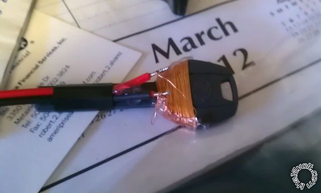

Just make sure that you have enough wraps around the key. Use the plastic valet key since you can concentrate the wraps around the head of the key. If you use the master key instead, use hot glue to keep the wraps in place and tape up the wires afterwards to ensure the wires won't slip down from the sweet spot where the transponder chip is.
We charge a minimum of $ 550 across the board for any BMW for a 1 way system because of the extra module that is required.

what is the going price? bmw remote start -- posted image.
example of a bmw valet key bypass. the wires you see need to be ran through a relay so that it only gets read by the car during remote start.
