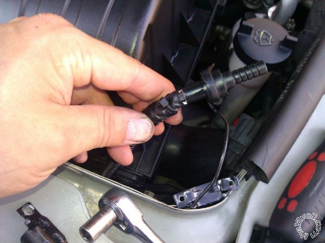

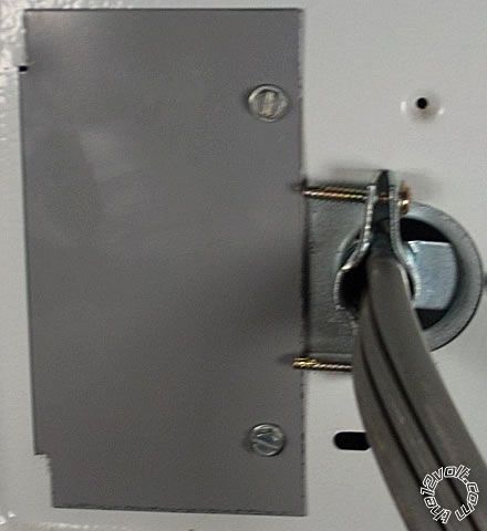

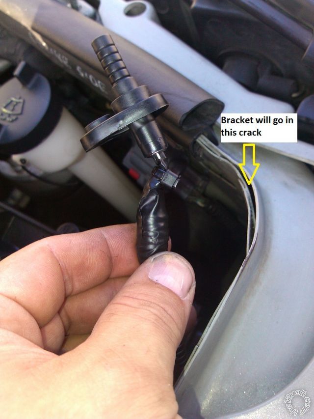

I installed my hood pin today. I looked and looked for a good spot to place the pin into the metal frame and I really couldnt find a spot I liked that would be free from water and also not get broke off if someone was working on the engine (like when installed in the front of car). So I rigged up something with a old dryer plug bracket I had laying around =)
This was what the bracket originally was like. I just bent the curves straight, folded one end of the back down, then shot it with some primer and black paint..
Hood Pin Mod Remote Start Alarm System Pictorial -- posted image.

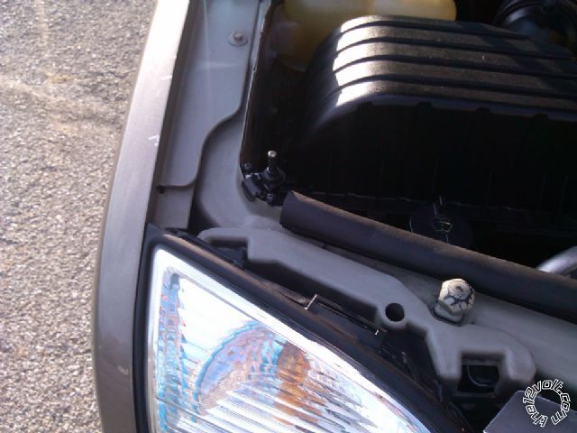

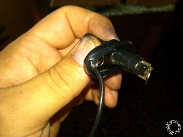

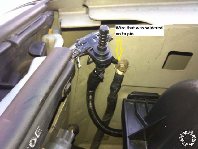

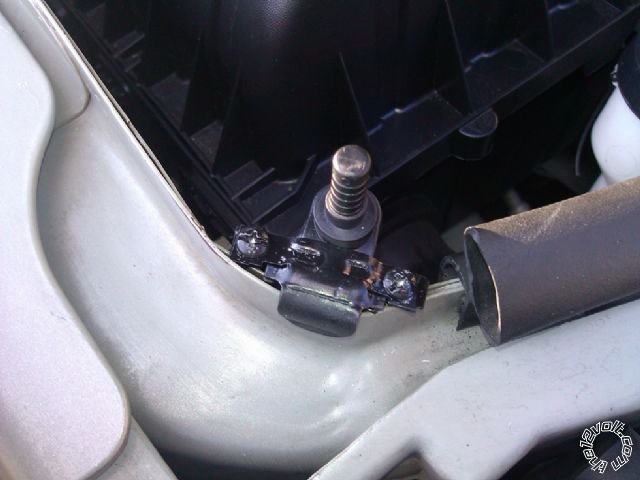

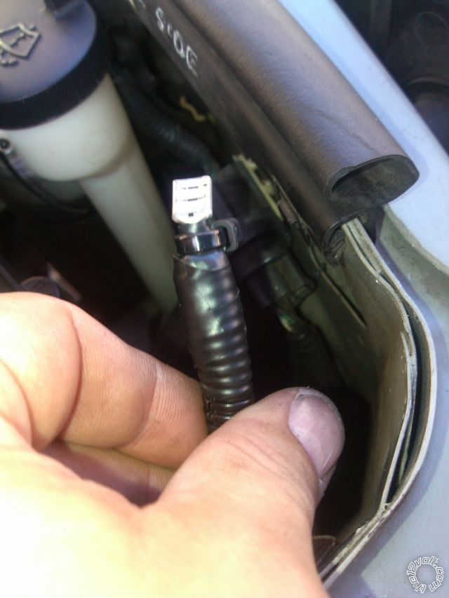

How I made it work..

I soldered a wire on to the metal bracket to make ground. You could make ground in another way but I feel it would help save from corrosion of any sort. I also made sure the top of the pin hit the hood head on by slowly closing the hood and looking inside and bending it slightly until it was right. I know if it his sideways sooner or later it would just break probably..
This mod would probably work with alot of different cars =)
(this was on a 04 mountaineer/explorer)
