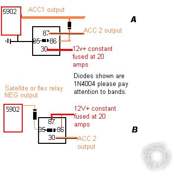

I'm putting in a Viper 5902 into a 2000 Chevrolet Silverado. I always prefer to hook up both ignitions and both accessories on GM's. I was going to use the PINK/BLACK to go straight to the 2nd ignition on the truck which leaves me with nothing for the 2nd accessory. How should I wire up an external relay and what from the brain will need to go to it. Thank you in advance!

https://www.the12volt.com/relays/relaydiagramm8.html#_index
Use the H2/12 orange wire from the viper
Posted: November 08, 2012 at 5:15 AM / IP Logged
Look at these two diagrams.
A is the simplest, B is if you have "flex" or satellite relay outputs or NEG triggers. I believe you do.
Don't forget the MANDATORY diodes or say goodbye to the 5902.
Standard Bosch/Tycho "cube" relays if only 5 terminal types are available, you can still use, just don't use 87a.
:- acc_2.bmp

And that should have been in diagram "B" but too lazy to look it up apologies and thanks to Chev!

The only problem with the one I posted is there are no diodes so i would combine the 2 diagrams and add the diodes to the one I posted. Or just use howie's B diagram
