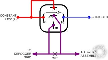

I have a '99 Tahoe with a Viper 5902 installed w/ SmartStart. I have (2) problems. The first, I don't know where to hook up the Blue/White Defroster wire from the Viper to the defroster circuit, behind the heater/AC assembly the defroster has a plug with 2 constant hots, a ground and the 4th wire is hot when the button is depressed and stays hot until it shuts off after a few minutes, Do I need a relay to connect my Viper to the defroster. Second, I installed the SmartStart and activated it myself through the website, via a user and password I found online, not being an installer, everything went fine except I didn't activate my aux channels, after I rec'd' my activation email, I completed and paid for the year, now when I try to use my Aux channel to operate my windows from my phone, it says "Aux wasn't activated at the time of install (36)" when I went back to the site and entered my airId, it says its not associated with the user anymore, I think because I never put in an installer e-mail when I activated the SmartStart. Can anyone help or direct me to what I need to do to get these (2) issues resolved. I would really appreciate any help.

You can use this diagram for your particular application. Ensure that you program the blue/white wire for latched output. The diode is optional but it is recommended.

You can also test to see if jumping (touch & release) one of the +12v wires to the +12v when button pressed, turns on the defrost (lights up the switch). If it does you don't need to cut the factory defrost wire just tap the relay into the +12v to 87,86 and the +12v when pressed to 30, 85 to trigger (set to pulse) This way the switch will time out just like normal, as if you pressed the button. This method is the preferred way so if the defrost mode is turned on in the summer the factory switch will shut it off by resistence instead of being latched until the remote start shuts off.

its not a very smart thing to just jump the 12v wires together, what if the switched wire rests at ground? you will blow a fuse or fry the control. if you want to jump the wires then you need to test it first to make sure the wire doesnt rest at ground. at the very least you need a 1A fuse inline when you go jumping wires to see if they work.
Posted: November 13, 2012 at 6:13 PM / IP Logged
91stt's diagram is 100% correct, also X 2 with soundnsecurity, sorry Lurch you are quite WRONG in what you suggest, but then we had this out last week didn't we.
What part of motor wire/hot window feed is GROUNDED at rest don't you realise.

Your 1999 Tahoe has an integrated solid state timer delay relay in the HVAC control switch assembly that operates the defogger for 10 minutes. The recommendation is to make your connections as indicated in the diagram provided. This is the safest method to activate the defogger. Tapping the violet wire with 12 volts will backfeed the control switch and may damage it since it is not known what is in that little black box. This method will work regardless of whether the wire normally rest at ground or not and will isolate the upstream components. The time and cost to cut and make the extra connection is insignificant compared to the cost to replace the control unit if it is damaged from the 12V backfeed.
Although not shown in the diagram, the 12 volt supply must be fused. Use a 30A fuse to match the factory fuse size.
