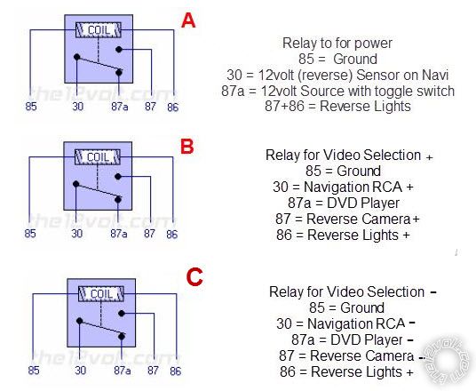

So I did some reading on the forums:
https://www.the12volt.com/relays/relays.asp
I then had this Idea pop up while preparing for bed and figure I had to type and draw it out before I forget it the next day.
What do you guys think?
Figure A
I needed to tell the Navigation that it is in reverse. The Navi thinks its in reverse when it detects 12 volt.
I set my 12 alternative 12volt source on PIN 87a since it is always connected when relay is not energized being as it is always connected the Navi will always think it is on so I will install a Toggle switch so that I can choose when to turn on my 12 volt source.
Next hurdle was I needed the reverse light to over ride my 12 volt source. so I wired PIN 87 and 86 to the reverse lights. So when I actually do go into reverse the lights will energize the coil causing the Arm to jump from PIN 87a to 87.
Figure B
So now I need to tell the Navi what video source to use. So a RCA connector has 2 wires inside one for ground and one for the signal.
So I wired pin 30 to the video input the Navi then DVD player's input to 87a and the Reverse camera to 87.
I connected 86 to the reverse lights so that when my car goes into reverse itll energize the coil which will disconnect the arm from 87a ( DVD PLayer ) and connect to 87 ( Reverse Camera ). Then when I shift back to another gear the coil will be de-energized and restore my DVD players video inputconfused about which relay to use -- posted image.
lurch228
Silver - Posts: 1,338
Joined: August 08, 2012
Posted: November 27, 2012 at 4:23 AM / IP Logged
If your going to use regular relays for the video you will need to use 2 relays to switch both the ground and video together. The one caveat is your video sources quality may suffer with non sheilded relays, they make video selectors that are designed to do what you want but they can be expensive and hard to find. At a minimum I would recomend a old video game RF adapter modified for your use which has the filters and noise traps built in. But it will require you to open it up and modify the circuit to bypass the RF conversion to channel 3 output so it passes the rca signal straight thru no conversion. It can be done as I have read posts to that fact in the past but have never done it myself.

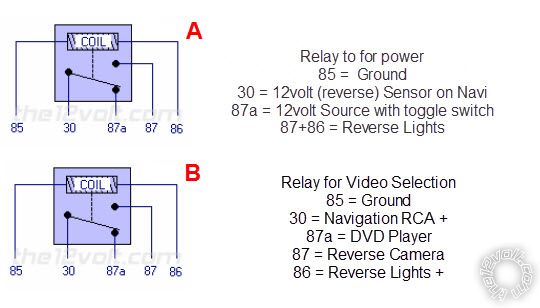

Posted: November 27, 2012 at 8:50 AM / IP Logged
Here is an updated one. I have a good feeling about this guys that it will work!

Posted: November 27, 2012 at 2:20 PM / IP Logged
For the concern of saving space if you can find them use micro relays as you don't have a high amp demand for what you are doing.
And you can use one relay for the video control of both the (+), (-) legs on each side. So as you can see in the below pic. You will have from left to right 2 banks of 3 connections plus the 2 coil connections on the right. Think of it as 2 relays in one but only one control coil switching both banks.
For example from let to right top 1 bank would be 87, 30, 87a,, 86 (+)
And bank 2 lower row of left to right pins will be 87, 30, 87a,, 85 (-)
