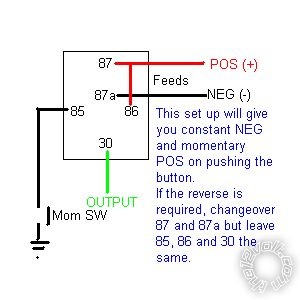

Posted: December 03, 2012 at 3:54 AM / IP Logged
You can do it this way, either constant NEG and momentary POS or vice versa.
You can also do it with a latching relay to give you either way constant but note latching relays will only give you up to 10 amps and you will need a SPCO momentary switch.
Method 1:- rev_pol.bmp

Ah - I took it to mean polarity reversal as in a window winder, antennae, etc.
Gotta love English...
Posted: December 03, 2012 at 11:42 AM / IP Logged
Good point Peter.What did the OP mean? Now I'm confused.
If we're talking motors antenna etc. DPCO centre off or SPCO centre off and two relays.

Well that's for the OP to clarify if it's an issue.
I think your single-pole reversal is more likely to be correct, but it might be a dual-pole for motor reversing etc if other contacts do the on-off.
Bit it's definitely a mom push button activation, hence SPDT or DPDT switch else SPST switch plus 1 SPDT or 1 DPDT else 2 SPDT for single and dual pole respectively.
