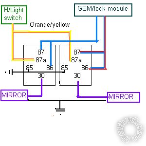

Posted: December 16, 2012 at 3:00 AM / IP Logged
If you connect to the parking light circuit they will be on constantly, even when indicating when your lights are on, you will probably have to also join to the wires I mentioned above then relay that side off when the indicators are on.
This diagram will give you the best of both worlds, 2 x Bosch/Tycho "cube" relays, standard automotive, available at any Radio Shack or auto parts store.
Note they will be slightly out of synch but hardly noticeable.

the aftermarket mirrors have a builtin park lights that go off when the turns come on
Blizzy
Posted: December 16, 2012 at 4:33 PM / IP Logged
So you need feeds from both parking lights and turn signals.
Well read the above posts or look at the diagram, colours and location.
