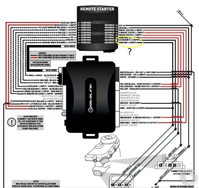

The bypass module wiring schematic is a little cryptic on the acc and ign wires hook ups to the R/S. They are drawn on the diagram as being an input for both wires on the R/S? I hooked them up under the assumption they are actually outputs, (and the diagram is not correct) like any other install.

The ignition and accessory wires on the remote start are considered an input and an output. Really they are outputs but some remotes starters use the ignition as an input for programming. Like autopage needs to see the ignition powered up and down 3 times to go into programming mode.
The same holds true for DEI RS and alarms.

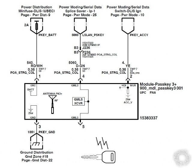

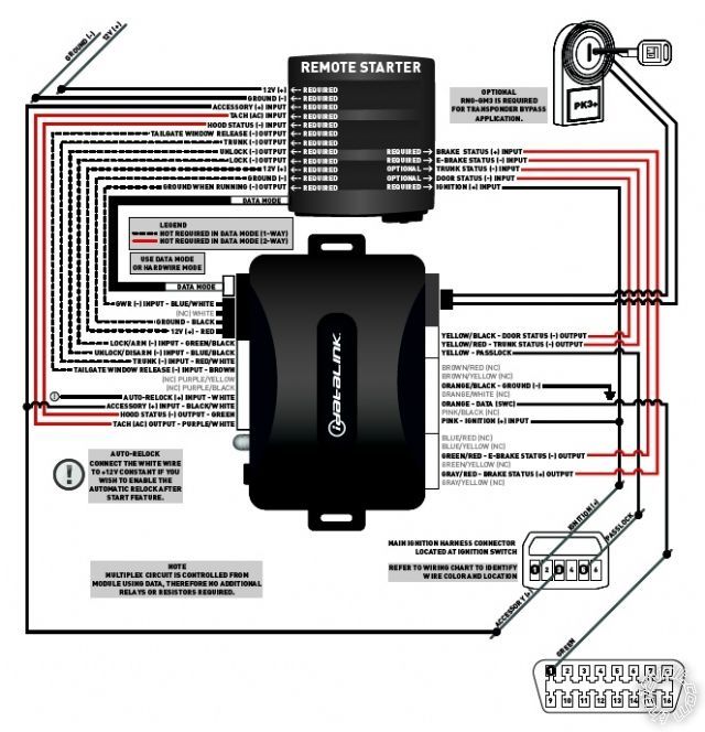

The adventure is complete. There where a couple of inconsistencies with the diagram that came with the bypass module. The biggest problem was the hookup for the data (SWC). As the diagram shows up above: it hooks up to the PK3+ module on pin 5. On this vehicle there was not a wire on 5, but looking at a vehicle schematic, pin 4 and 5 are wired together internally at the PK3+ so I hooked it up to pin 4. The bypass would program up just fine but would not work on a remote start. (possible interference issues?)
2012 silverado 1500 rs issues. -- posted image.
There was a second diagram on this units manual that shows the data line tied into pin 1 of the OBD data port. I tried it there and things are working great.

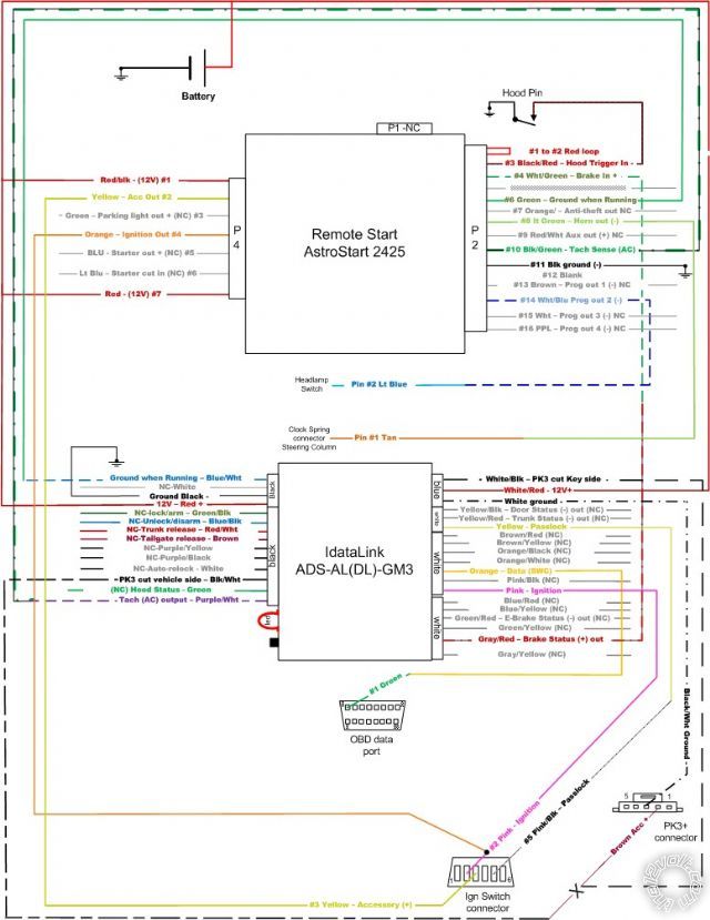

The below schematic is the working version of this install:
