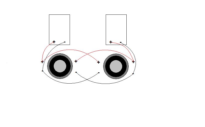

Okay I have 2 DVC 2 ohm subwoofers and 2 1200 watt amps that are both 1 ohm stable. Okay if I wire 1 set of positives and negatives from one sub to another set of positive and negative on the other sub and then to the amp, the amp will see that load as a 1ohm load right? And I'm going to do the same thing for the other positives and negatives on the subs. Will this all work and will there be 2400 watts going to each sub and will it be a 1 ohm load on each amp?

It will not work you cannot bridge 2 amps together like that! But if you have a sub and each coil is 2 ohm and you wire it in parallel + to + and - to - then it will present the amp with a 1 ohm load. that will give the sub 1200 watts which is the same as 2400 watts X 2 subs. So to sum it all up  wire 1 amp to one sub and wire them in parallel, do the same for the other sub and amp ,and you will get 1200 watts into each sub which is the same thing as 2400 watts going into 2 subs.

The top diagram here http://www.audiobahninc.com/tech/wiring/parallel_parallel_dual_2.pdf shows you how to wire each sub to each amp. Now just to be sure it’s a 2 ohm DVC and that the diagram above is correct ,what is the make and model # of your subs.

2 Audiobahn AW1208Q, sorry i can't get my diagram of what i'm talking about to show up

The best way to do it to maximize your power would be to run each sub off its own amp and wire the voice coils in parallel. Even if you could bridge the 2 amps into one and you gave both subs 2400 watts they would still only get 1200 watts a piece.
