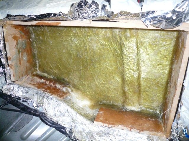

General question about subwoofer performance in certain or cold climates. I suppose this question could apply to any similar subwoofer and enclosure setup?

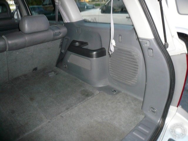

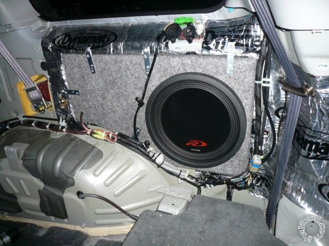

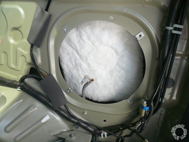

I have an Alpine Type R 10" shallow sub (SWR-T10) in a 0.42 cu ft sealed fiberglass / MDF enclosure molded and bolted directly in the factory sub location behind the pass side factory cargo panel in my 2004 Honda Pilot. Scroll down for pictures.This woofer has amazing sound quality and does achieve 127dB at 45hz with 300 watts RMS from an Alpine PDX-5.
I retired from the U.S. Navy in Sep 2011, then went to The Installer Institute in Holly Hill, FL near Daytona Beach till December 2011. I've been in Laramie WY. since June 2012 attending Wyotech.
I built and installed this enclosure while at The Installer Institute. I've been in relatively warmer climates ever since. Here in Wyoming, it started getting colder here in October, and for the past 2 weeks and it's been ultra cold here getting near or below zero in the mornings.

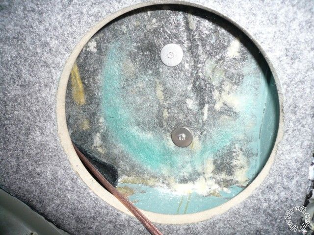

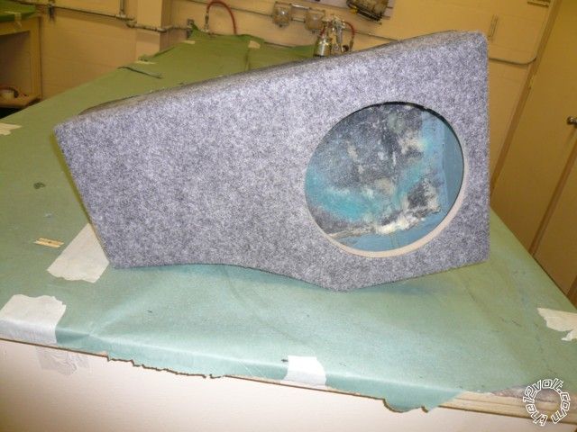

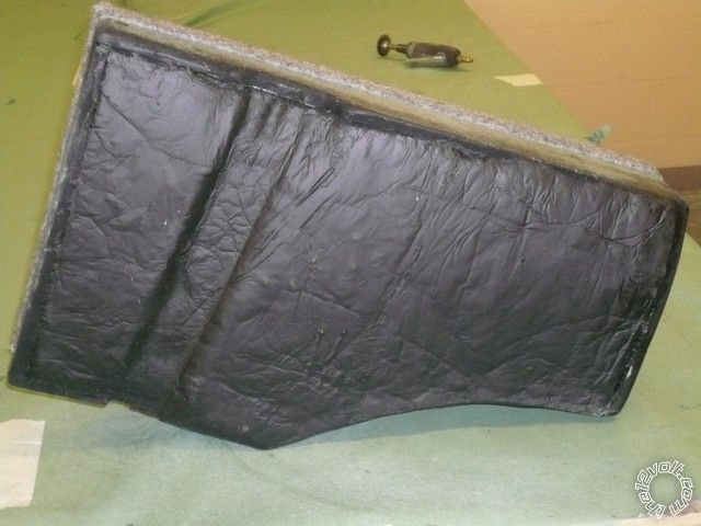

I'm noticing very diminished bass performance during extreme cold. After I play music for 10 minutes or so and the interior is warmer, then the bass performance gets better. If my enclosure was just a regular box in the cargo area, then this probably wouldn't be as noticeable. But since the enclosure is made of MDF on the front baffle and sides, but fiberglass on the enclosure rear molded to the outer body panel from inside the cavity and bolted directly to the vehicle.........could the cold effect bass performance or cause the fiberglass or enclosure to crack or have structural defects? The fiberglass is mated to the MDF using Duraglas on the inside edges.

Hey Toy, it may not be your Sub box. looks solid from the pics. in cold temp your battery will give lower amp out and your system (amp, head unit) need to be at a certain temp to run at peek performance. Most car amps are spec at 65-82 deg operating range.

To prevent fiberglass from cracking, I'd also like to add that you could try sandwiching rabbit wire (screening) between your fiberglass layers to add extra strength to your enclosure and/ or maybe use a can of rubberized undercoating over the top of that (inside the enclosure) to help kill the internal vibration?

I have never tried using rabbit wire in any of my fiberglass since the glass in my fiberglass is quite strong and the next hardest thing to diamonds, so I personally would not attempt adding any rabbit wire to your enclosure.
I think that your reduced bass output is due to the cold suspension components of your subwoofer adding mechanical resistance to the woofer and consequently lowering the woofers tenancy to resonate at the lower end of its pass-band.
Looking at your pics the enclosure looks very nice and well made, however I can't tell by the pics how thick the glass actually is and I wonder how you attached the front baffle to the enclosure (screw and glue?).
In any event the problem would not go a way and then occur again if a structural flaw was the problem. I say if you are worried about the enclosure cracking then you should push the sub hard every day, rock out, enjoy it, and then repair or rebuild the enclosure as it should have been in the first place if it fails. If it never fails then you did a good job.bass performance in cold climates -- posted image.
