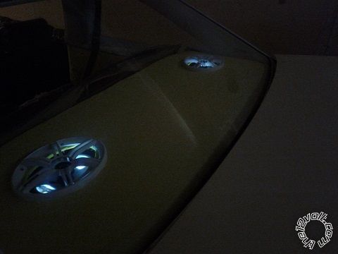

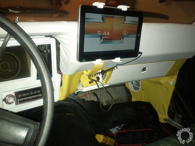

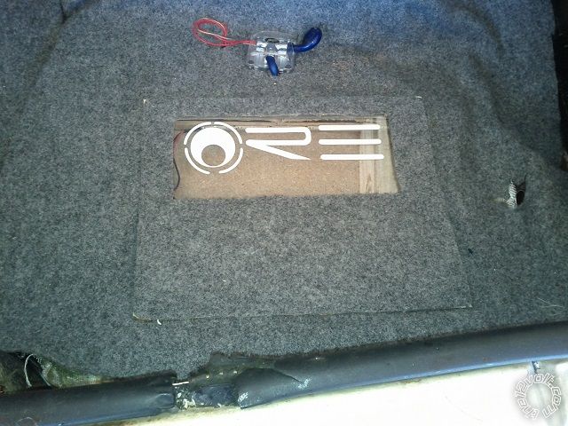

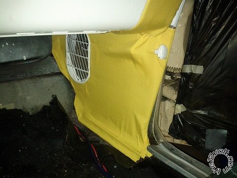

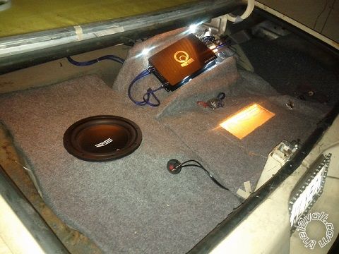

heres the chevy nova tablet pics i promised i have it wired straight to the amp from the tablet and i added a bluetooth module because a 10" tablet with bluetooht is pricey so you just unplug the 3.5mm cable from the tablet and connect it to the 3.5mm connector in the ash tray any you cant play any blue tooth device in the nova tell me your thoughts
