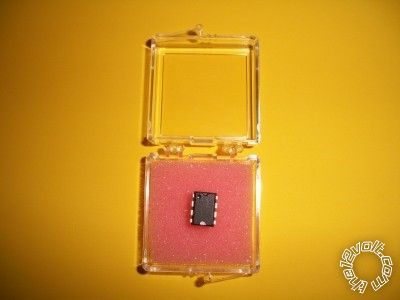

The chip upgrade is just an 8 prong IC chip that gets replaced in the BitWriter.
Bitwriter for Viper 5701 -- posted image.

This answered one of my questions as well. I ordered a 998T as well, comes with 2.7.   Then I saw in manual 998U and I thought ******!

The Ver 2.9 upgrade chip is only $15 and you won't need it on Viper units ( yet ).
