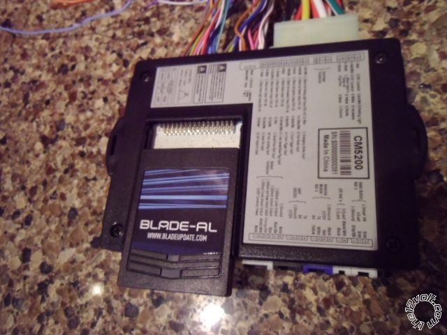

just curious why wouldn't the ads blade work with the avital if done w2w ?
Platinum - Posts: 7,827
Posted: January 16, 2013 at 7:19 PM / IP Logged
The Blade AL is a small cartridge that slides into a slot in the Compustar ( and some Excalibur ) remote start units.  It is the functional equivalent of the ADS AL-CA bypass module.
Here is a link to the Excalibur site for their info :  http://www.caralarm.com/Excal_2010/Excal_2010.html
Here is a picture of a Blade AL almost fully inserted into a Compustar CM5200
03 envoy r/s alarm combo avital 5103 -- posted image.

Ahhh I've never used one always use the ads-al-ca
