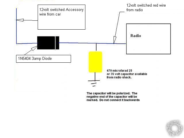

connect a multimeter in series (ammeter function) on the accessory lead.
measure current used with different sources, hopefully should be rather minimal. pick a diode with a value greater than maximum current measured, won't hurt to be generous and overrate the diode. next obtain
electrolytic capacitors, 25volt rated, start around 1000uF. wire diode in series on accessory lead, connect capacitor between accessory lead (head unit side of diode) and ground. the diode keeps the radio and capacitor isolated from the vehicle electrical system while the voltage drops, the capacitor supplies the radio with power. may need to increase the value of capacitance (add additional in parallel) depending on current requirements on the accessory lead of the headunit.

No need to measure the current. I will try to find the post with a diagram of what Ween was explaining.
The pic was drawn for a little different application. Read the post as well as looking at the picture.
Read this Thread

Is this correct?? Sorry didn't mean to plagiarism!!!!
Find True Ignition Wire -- posted image.
The best tool in my work shop, is my BRAIN!!!!
Platinum - Posts: 13,719
Posted: January 23, 2013 at 4:05 PM / IP Logged
That would be it. If that does not keep it on long enough, parallel a second capacitor, or just buy a 1000 microfarad device from jump.

I was worried this was an issue of using ACC which dropped out during cranking (hence use 2 diodes, one from ACC and one from IGN as often done to keep relays energised from the ACC circuit powered during cranking).
But no, it seems to be a simple voltage drop whilst cranking issue and that circuit should work fine. [Noting the diode voltage drop of ~.6V or more but a Schottky diode can halve that; it won't hold up against longer cranks; and too large a capacitor will blow the diode (too much cap inrush current).]

IAAI, I'll stick with a 1000 microfarad to be safe.
